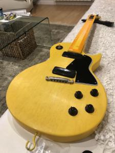

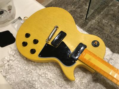

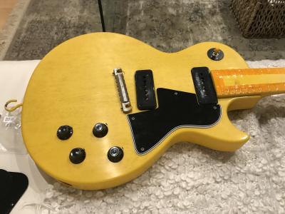

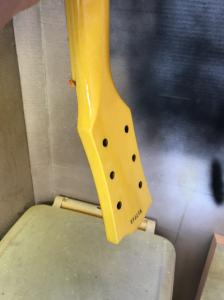

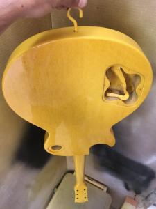

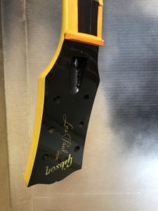

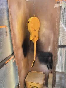

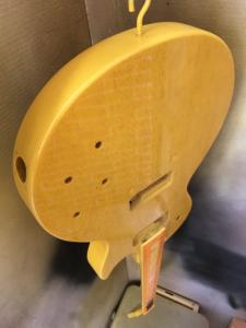

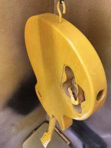

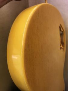

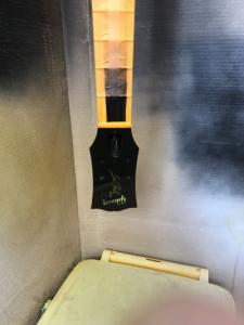

Bueno, después de esta chapa, así es como ha quedado el tono del tv yellow tras infinidad de manos de ámbar:
index.php?controller=forum&action=view_attachment&attachment_id=115972
index.php?controller=forum&action=view_attachment&attachment_id=115973
index.php?controller=forum&action=view_attachment&attachment_id=115974

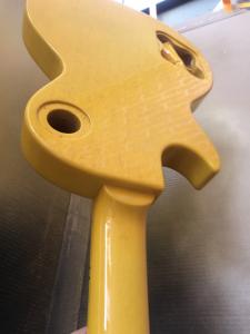

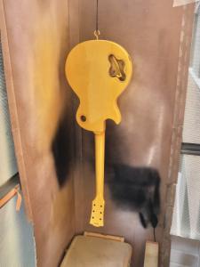

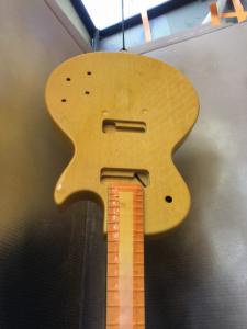

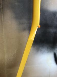

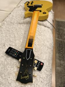

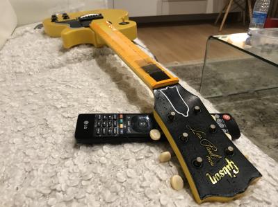

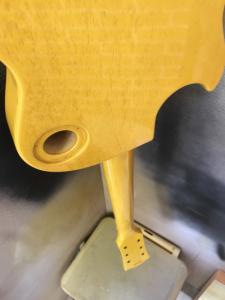

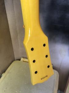

En detalle:
index.php?controller=forum&action=view_attachment&attachment_id=115975
index.php?controller=forum&action=view_attachment&attachment_id=115976
index.php?controller=forum&action=view_attachment&attachment_id=115977
index.php?controller=forum&action=view_attachment&attachment_id=115978
index.php?controller=forum&action=view_attachment&attachment_id=115979
index.php?controller=forum&action=view_attachment&attachment_id=115980
index.php?controller=forum&action=view_attachment&attachment_id=115981
index.php?controller=forum&action=view_attachment&attachment_id=115982
index.php?controller=forum&action=view_attachment&attachment_id=115983
index.php?controller=forum&action=view_attachment&attachment_id=115984
index.php?controller=forum&action=view_attachment&attachment_id=115985
index.php?controller=forum&action=view_attachment&attachment_id=115986
index.php?controller=forum&action=view_attachment&attachment_id=115987
index.php?controller=forum&action=view_attachment&attachment_id=115988

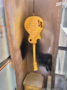

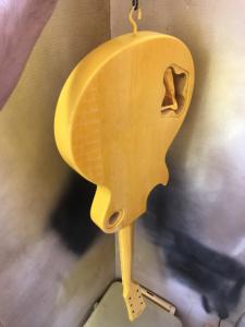

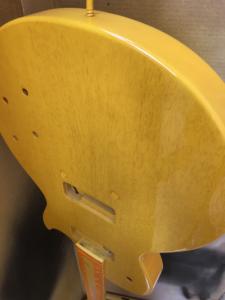

Tras lijado al agua, fantaseando con cómo va a quedar...
index.php?controller=forum&action=view_attachment&attachment_id=115989
index.php?controller=forum&action=view_attachment&attachment_id=115990
index.php?controller=forum&action=view_attachment&attachment_id=115991
index.php?controller=forum&action=view_attachment&attachment_id=115992
index.php?controller=forum&action=view_attachment&attachment_id=115993

Es increible!!!! Es preciosa!!! como ha mejorado el logo de Gibson, lo has amarilleado?

Qué caña, ahí pintando en el tendedero entre cartones :okis:
