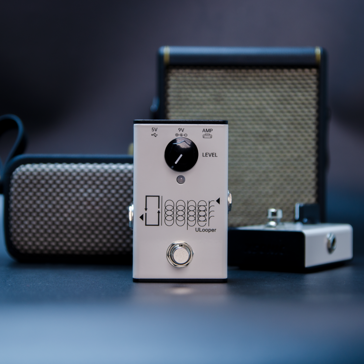

#1233 por lo que he leido, ese problema con drivers y windows etc,,, es de una remesa de Sparks 40 del año 2023. el mío es anterior. imagino que los que salen ahora también estarán arreglados... digo yo.
y por cierto,, hace poco me llegó un correo de publicidad de este cacharro de un looper que han sacado para los amplis estos de Positive Grid :):
https://xsonicaudio.com/pages/ulooper
y precisamente ahí especifica que los de la remesa esa con el fallo no funciona bien este looper:
Compatibility
Currently, ULooper is compatible with all Spark models, including Spark 40, Spark MINI, Spark GO, and Spark Live.
However, it is important to note that a small number of Spark 40 units from specific production batches may not be supported, they are all originate from production batches starting in the second half of 2023. These particular Spark 40 units are characterized by a 44.1 kHz USB audio sampling rate and experience compatibility issues with Positive Grid's proprietary Windows ASIO drivers which can test and download here. If your Spark 40 operates at a 48 kHz sampling rate or the ASIO driver is functional, there will be no compatibility issues.
Please note that this issue exists only with the Spark 40, other models do not have this issue.
