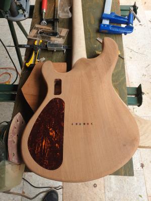

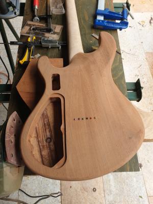

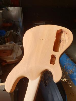

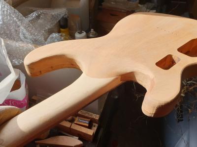

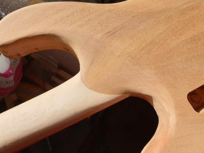

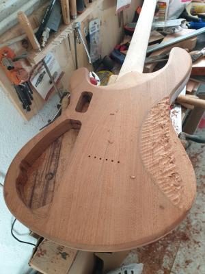

Rematando los rebajes traseros.
index.php?controller=forum&action=view_attachment&attachment_id=164472
index.php?controller=forum&action=view_attachment&attachment_id=164473
index.php?controller=forum&action=view_attachment&attachment_id=164474
index.php?controller=forum&action=view_attachment&attachment_id=164475
index.php?controller=forum&action=view_attachment&attachment_id=164476

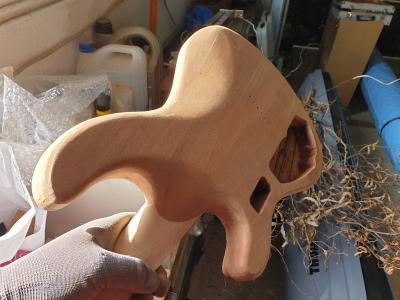

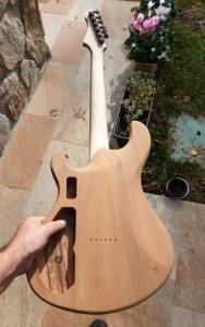

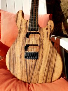

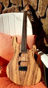

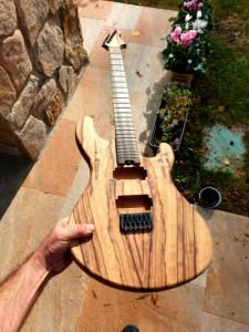

Y aquí un par aprovechando un poco de sol
index.php?controller=forum&action=view_attachment&attachment_id=164477
index.php?controller=forum&action=view_attachment&attachment_id=164478

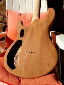

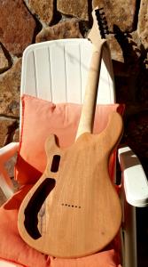

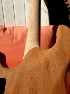

Toca rectificar trastes, aunque no hay muchos desniveles. He podido conseguir una acción cómoda pese a ello.
index.php?controller=forum&action=view_attachment&attachment_id=164504
index.php?controller=forum&action=view_attachment&attachment_id=164505
index.php?controller=forum&action=view_attachment&attachment_id=164506
index.php?controller=forum&action=view_attachment&attachment_id=164507
index.php?controller=forum&action=view_attachment&attachment_id=164508
