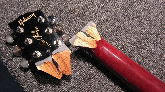

Gibson Announces Broken-Neck Limited-Edition Les Paul. The Price is $9,999
Era una broma jeje
