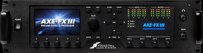

Bomba vaaa!
risingjul
por el 29/01/2018
#3238 Madre mia!!!! que bicharraco!!!!!
"The price is $2499. First units expected to start shipping March 1st. "
Y ahora que????
