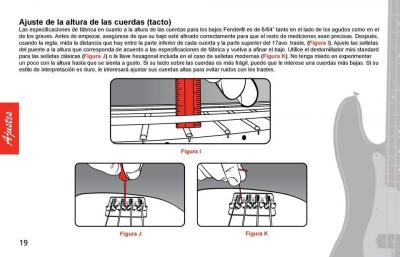

Jureweah
por el 29/10/2021
index.php?controller=forum&action=view_attachment&attachment_id=164399

https://fendercustomersupport.microsoftcrmportals.com/en-us/knowledgebase/article/KA-02007
