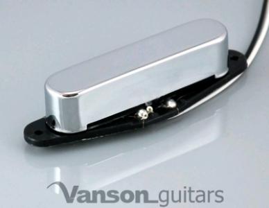

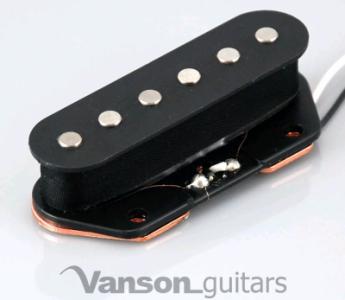

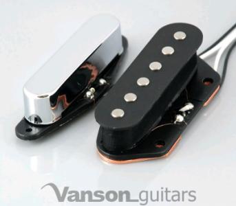

Buenas, ¿Alguien sabe que tal son estas pastillas en comparación con las que trae la Standard Mejicana?
Vanson 'Vintage 50' AlNiCo V Telecaster® Pickups
Magnet: AlNiCo V, Resistance: Bridge 6.0k, Neck 6.5k ( +/- 5%), Brass-backed
Please choose Position required from the drop-down menu
Let's face it, if you read all the advertising hoodoo from well-known Branded pickup manufacturers they'll make you think that you need to spend upwards of £60 or even £100 to get a truly 'Authentic' Tele® tone.
We like to think that if you get the basics right on a good Telecaster pickup you'll be about a third of the way there, but a lot of your tone will also come from having a decent Tweed-type valve amp, and the rest is up to your fingers. Have you noticed how the great players sound good on any instrument? So, our philosophy is do get yourself a decent set of pickups, but you'll not find any 'Magic' by breaking the bank. Put the rest towards a good amp, some lessons, or a gig ticket for some inspiration.
With that in mind we've come up with our Vanson 'Vintage 50' Telecaster Pickups. They are balanced the old way, and so have a higher resistance on the Neck because of the nature of the 2 different pickup types (geometry, covers, typical height, steel bridge etc). Essentially they sound right when you use your ears as opposed to judging everything by its resistance value, which is futile (but that's another story). Utilising Alnico V polepieces, they'll offer up all the twang and shimmer you'll need for a vintage tone, ...enough said.
So, hopefully you'll agree with us when you try them and realise that you don't need to pay the earth for great tone.
Screws & Springs included. All products are shipped OEM and your items will be sent as pictured, in protective packaging.
* PLEASE NOTE: Vansonguitars are NOT affiliated with Fender Musical Instrument Corporation or any other musical instrument manufacturer IN ANY WAY. Fender®, Strat®, Stratocaster®, Tele®, Telecaster®, and Squier® are registered trademarks of Fender Musical Instruments Corp. Vansonguitars is in the business of manufacturing and supplying replacement guitar parts and in NO WAY IMPLIES THAT IT BUILDS OR SELLS FENDER® GUITARS OR FENDER® GUITAR PARTS. This is NOT a Fender® product.
