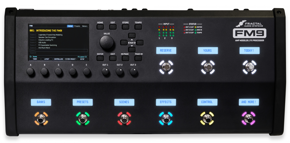

Nuevo FM 9 que estará entre 1900 y 2000€ en EU
https://www.g66.eu/es/products/fractal-audio/fm9

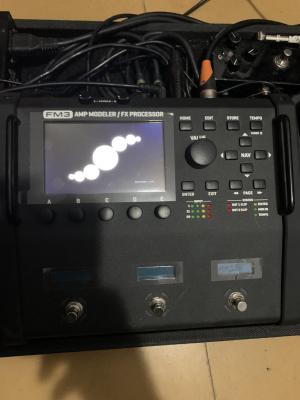

Hola compañeros alguien me podría ayudar con este problema del fm3, lo enciendo y se queda en esta pantalla. Con el mensaje boot loader: 1, que puedo hacer? A alguien le a pasado ?

#5082 Ni idea, supongo que que se ha quedado colgado, no se si por problema de firmware, actualizacion o errores...
El manual dice esto para resetearlo, uno ma slight y otro mas intenso:
PROBLEMS DURING/AFTER FIRMWARE UPDATE The FM3 has a built-in recovery system known as the “Emergency Boot Loader” to protect you against mishaps during firmware update. To boot from the emergency boot loader: 1. Power down the unit and wait five seconds. 2. Power on holding both PAGE LEFT and PAGE RIGHT buttons until the Emergency Utility page appears. 3. Update as normal using Fractal-Bot.
PROBLEMS WITH GLOBAL SETTINGS OR PARAMETERS In the very unlikely event that a problematic system parameter prevents the FM3 from booting normally, you may use the following procedure to recover: 1. Power down the unit and wait five seconds. 2. Power on holding EDIT until the boot-up progress bar first appears. 3. Enter SETUP, open the Utilities menu, and page to Reset. 4. Execute Reset System Parameters as indicated on-screen (Push-knob A followed by ENTER). WARNING! Do NOT accidentally perform CLEAR ALL PRESETS!!! 5. Follow the on-screen instructions to execute. Press HOME when finished.

Efectivamente, lo he podido solucionar, gracias por la info, risingjul, me sirvió, había perdido el manual. Un abrazo máquina.
