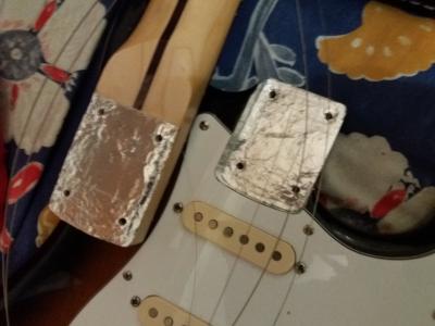

[img: URL no es una imagen - Hola%20a%20todos,%20os%20voy%20a%20presentar%20un%20método%20creo%20que%20innovador%20para%20ajustar%20el%20mástil. En%20primer%20lugar%20deciros%20que%20este%20método%20lo%20he%20pensado%20después%20de%20varios%20días%20luchando%20con%20ajustar%20el%20mástil%20de%20la%20manera%20tradicional%20es%20decir%20con%20calzos%20y%20con%20resultados%20poco%20favorables%20para%20mi,%20como%20soy%20un%20maniático%20del%20ajuste%20bajo%20de%20la%20guitarra%20y%20al%20no%20quedar%20agusto%20con%20el%20ajuste%20que%20tenía%20con%20los%20calzos,%20subiendo%20y%20bajando%20las%20selletas%20etc...%20me%20puse%20a%20pensar%20en%20alguna%20solución%20y%20os%20presento%20la%20que%20he%20inventado%20(creo). En%20primer%20lugar%20decir%20que%20mi%20guitarra%20tenía%20el%20mástil%20un%20poco%20desgastado%20de%20trastes%20y%20me%20dispuse%20a%20comprar%20uno%20nuevo%20puesto%20que%20restrastearla%20no%20me%20compensaba%20económicamente%20y%20además%20quería%20cambiar%20el%20de%20arce%20por%20uno%20de%20palisandro.%20Tras%20adquirir%20el%20nuevo,%20barnizarlo,%20ponerle%20un%20calco%20y%20dejarlo%20bonito,%20rebaje%20el%20talón%20porque%20era%20algo%20más%20grueso. Al%20principio%20parecía%20todo%20bien%20pero%20al%20poner%20el%20´nuevo%20mástil%20resultó%20que%20la%20acción%20no%20me%20quedaba%20bien,%20no%20es%20que%20fuera%20exagerada%20pero%20no%20quedaba%20baja%20como%20a%20mi%20me%20gusta,%20ni%20bajando%20selletas%20ni%20calzando%20con%20maderitas%20ni%20dando%20angulo%20ni%20de%20ninguna%20manera. Bueno%20vamos%20al%20lío. Se%20trata%20de%20un%20método%20que%20muchos%20puristas%20me%20podrán%20criticar%20pero%20que%20a%20mi%20me%20ha%20servido%20con%20eficacia%20y%20sencillez. Material%20a%20necesitar: Cinta%20de%20aluminio%20de%20la%20que%20se%20pega,%20una%20normal%20de%20los%20chinos%20vale. Masilla%20de%20madera%20o%20masilla%20reparadora%20de%20madera. El%20concepto%20es%20el%20siguiente,%20como%20no%20conseguía%20adaptar%20el%20calzo%20a%20la%20medida%20exacta%20y%20la%20forma%20del%20talón%20pensé%20que%20podía%20idear%20un%20sistema%20en%20donde%20el%20calzo%20se%20adaptase%20al%20hueco%20del%20talón%20y%20ajustarse%20a%20medida. La%20idea%20es%20la%20siguiente: Primero%20debemos%20aflojar%20las%20cuerdas,%20no%20quitarlas%20porque%20nos%20van%20a%20servir%20de%20referencia%20y%20además%20nos%20evitamos%20el%20rollo%20de%20ponerlas%20que%20es%20una%20lata,%20las%20aflojamos%20de%20manera%20que%20quedan%20sin%20tensión%20y%20en%20mi%20caso%20las%20sujeto%20con%20una%20cejilla%20de%20manera%20que%20no%20se%20muevan%20ni%20se%20salgan%20de%20la%20cejuela,%20en%20el%20tercer%20traste%20quedan%20bien%20sujetas. Ponemos%20la%20selletas%20a%20una%20altura%20media%20para%20que%20luego%20nos%20de%20la%20opción%20de%20subir%20o%20bajar%20el%20ajuste%20. Procedemos%20a%20desaflojar%20los%20tornillos%20del%20mástil%20hasta%20soltar%20el%20mismo. Una%20vez%20soltado%20el%20mástil%20del%20cuerpo%20se%20procede%20a%20forrar%20el%20hueco%20y%20la%20parte%20del%20mástil%20que%20estará%20en%20contacto%20con%20el%20hueco%20del%20mástil. Os%20preguntaréis%20porque%20esto?,%20pues%20bien%20porque%20si%20ponemos%20la%20masilla%20directamente%20en%20el%20hueco%20se%20nos%20pegará%20el%20mástil%20de%20forma%20definitiva%20al%20hueco%20y%20no%20queremos%20tener%20un%20mástil%20encolado,%20al%20poner%20la%20cinta%20podremos%20en%20caso%20necesario%20volver%20a%20quitar%20el%20mástil%20sin%20problemas. Una%20vez%20forrado%20el%20hueco%20y%20el%20talón,%20la%20cantidad%20justa%20para%20que%20quede%20cubierto,%20procedemos%20a%20poner%20la%20masilla%20en%20el%20hueco%20extendiéndola%20bien%20de%20forma%20uniforme,%20con%20poner%20unos%20dos%20milímetros%20o%20tres%20basta%20pues%20el%20sobrante%20saldrá%20solo%20al%20apretar%20los%20tornillos. Una%20vez%20rellenado%20el%20hueco%20con%20ese%20digamos...%20calzo%20blando%20de%20masilla%20ponemos%20el%20mástil%20con%20cuidado%20y%20ahora%20viene%20lo%20fino,%20se%20trata%20de%20ir%20apretando%20los%20tornillos%20con%20cuidado%20para%20que%20el%20mástil%20quede%20bien%20recto%20y%20ligeramente%20levantado%20de%20la%20parte%20superior%20para%20que%20no%20trasteen%20las%20cuerdas.%20Una%20vez%20puestos%20aun%20sin%20apretar%20los%20tornillos%20quitamos%20la%20cejilla%20para%20que%20las%20cuerdas%20nos%20sirvan%20de%20referencia%20real,%20nos%20vamos%20fijando%20que%20quede%20lo%20más%20pegado%20a%20las%20cuerdas%20posible%20y%20apretando%20poco%20a%20poco%20los%20tornillos%20en%20pares,%20los%20de%20arriba,%20y%20los%20de%20abajo%20juntos%20para%20dar%20el%20ángulo%20correcto. Podemos%20tensar%20un%20poco%20ya%20las%20cuerdas%20para%20ver%20como%20va%20quedando. A%20medida%20que%20vamos%20ajustando%20la%20masilla%20sobrante%20va%20saliendo%20como%20de%20un%20sándwich%20de%20paté,%20la%20vamos%20quitando%20con%20un%20trapo%20y%20cuidado%20con%20manchar!!! Cuando%20veamos%20que%20al%20tocar%20las%20cuerdas%20no%20nos%20trastean%20y%20la%20altura%20esta%20bien%20dejamos%20de%20apretar%20los%20tornillos%20y%20dejamos%20que%20seque%20la%20masilla. Ventajas%20de%20este%20ajuste: El%20calzo%20que%20queda%20es%20totalmente%20ajustado%20al%20hueco%20y%20la%20forma%20necesaria. Al%20ser%20madera%20no%20resta%20sustain,%20al%20menos%20apreciable. Es%20totalmente%20reversible,%20la%20masilla%20se%20vuelva%20a%20ablandar%20con%20acetona%20y%20se%20quita%20fácilmente. Consejos:%20poner%20un%20trapo%20debajo%20de%20la%20guitarra%20para%20no%20manchar.%20Las%20manchas%20salen%20fácilmente%20con%20alcohol%20o%20acetona. Espero%20que%20os%20pueda%20servir,%20es%20un%20método%20poco%20ortodoxo%20pero%20para%20mi%20ha%20sido%20efectivo,%20yo%20lo%20aconsejo%20cuando%20el%20ajuste%20se%20resiste%20con%20el%20sistema%20de%20calzos,%20digamos%20mástiles%20rebeldes%20je,je. Un%20saludo%20a%20todos.]

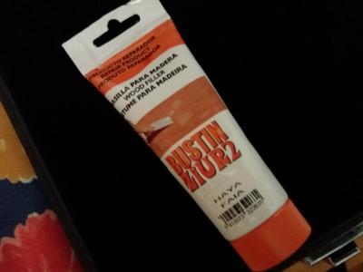

Bueno, esta masilla es madera que una vez seca se queda como madera y con una dureza similar, el disolvente que lleva no es agua por lo que seca rápido...
No cantaré victoria entonces je,je.
Dentro de un par de años firmo el invento y lo paso por derechos de patente :jajajaja:

Bueno la masilla que he empleado se endurece y queda como la madera, solo se puede quitar si la vuelves a disolver con acetona pues va con un disolvente fuerte por lo tanto tiene buena densidad para transmitir bien las vibraciones, yo no he notado caída en el sustain ni en el tono.
