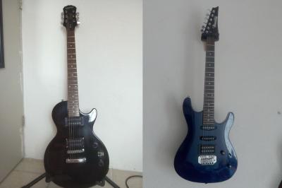

[img: URL no es una imagen - Buenas%20noches%20carnales,%20el%20motivo%20de%20mi%20comentario%20es%20más%20que%20nada%20para%20ver%20si%20me%20pueden%20guiar%20un%20poco%20en%20los%20temas%20siguientes: Resulta%20que%20tengo%20dos%20guitarras,%20una%20epiphone%20special%20ll%20y%20una%20ibanez%20gio,%20a%20la%20primera%20le%20quise%20realizar%20cambio%20de%20cuerdas%20y%20ahora%20que%20le%20coloqué%20las%20nuevas%20pues%20creo%20que%20necesitara%20calibración%20o%20algo%20ya%20que%20se%20me%20desafina%20en%20menos%20de%20lo%20que%20termino%20de%20tocar%20una%20rola.%20Con%20la%20ibanez%20me%20pasa%20lo%20mismo%20pero%20a%20esa%20no%20le%20hice%20cambio%20de%20cuerdas,%20solo%20de%20la%20primera%20porque%20se%20rompió,%20y%20no%20solo%20eso,%20el%20potenciometro%20de%20volumen%20me%20esta%20generado%20bastante%20ruido%20que%20incluso%20tengo%20que%20jugarle%20bastante%20hasta%20que%20deje%20de%20hacerlo%20y%20poder%20coger%20un%20buen%20sonido%20(esto%20me%20trae%20de%20cabeza). Acudí%20a%20dos%20lugares%20(tiendas%20de%20música)%20y%20me%20hicieron%20el%20presupuesto%20de%20la%20epiphone%20diciendo%20que%20solo%20era%20octavarla%20y%20cambio%20de%20cuerdas%20y%20que%20con%20esa%20quedaba,%20pero%20de%20la%20ibanez%20lo%20mismo,%20que%20hay%20que%20octavarla%20y%20cambiarle%20el%20potencometro.%20Los%20montos%20en%20la%20tienda%201%20fueron%20de%20$500%20por%20la%20epiphone%20y%20$700%20por%20la%20ibanez%20(no%20incluye%20el%20potenciometro%20de%20la%20marca%20ALFA);%20en%20la%20tienda%202%20me%20cobran%20$250%20por%20la%20epiphone%20y%20$400%20por%20la%20ibanez. Ahora%20la%20pregunta%20es,%20¿Son%20convenientes%20estos%20precios?%20¿realmente%20cuánto%20es%20lo%20que%20se%20cobra%20por%20calibrar%20la%20guitarra%20y%20cuánto%20por%20cambiar%20un%20potenciometro? Perdón%20por%20la%20biblia%20que%20me%20aventé%20pero%20quiero%20ser%20lo%20más%20especifico%20posible%20para%20que%20me%20puedan%20apoyar,%20de%20antemano%20les%20agradezco%20mucho%20carnales.]

Bunbury Fitta escribió:
¿realmente cuánto es lo que se cobra por calibrar la guitarra y cuánto por cambiar un potenciometro?
Realmente cada quien cobra por su trabajo lo que considere conveniente, otra cosa es que como cliente decidas o no pagarlo. Dicho esto, los precios de la segunda tienda me parecen más realistas que los de la primera. Aunque a decir verdad, puedes ahorrarte ese dinero aprendiendo tu mismo a ajustar tus guitarras y aprendiendo a usar el cautin para soldar.
Por cierto, que una guitarra desafine muy rapido se debe a varios factores y no al ajuste como tal. Ojo si intentan venderte que el ajuste es la solución a eso.

Antes que nada gracias por atender la solicitud. Si, de echo tienes razón, el cliente decide si lo paga o no. Más que nada mi duda es para saber cuanto es lo correcto porque si es lo barato a veces hacen chambonas. Por otro, si se soldar y de más cosas, lo que no sé es que poteciometros debo comprar ya que he tratado de asesorarme en internet pero unos dicen una cosa y otros otra, pero bueno seguire buscando; y lo del ajuste pues si se me hace un tanto complicado (al menos porque nunca lo he echo) ya que igual he buscado en internet y me sale que debo tener un chingo de cosas para poder hacerlo, desde los materiales para la limpieza como unos cartoncillos (por así llamarlos) que traen las medidas de la altura de las cuerdas y demás cosas que no tengo. Pero ya que me regalaste tus comentarios entonces me surge otra pregunta, ¿cómo puedo estar seguro de lo que es en caso de no ser ajuste, octavación, el cambio de calibre de las cuerdas, etc...?
