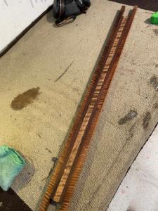

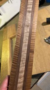

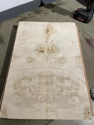

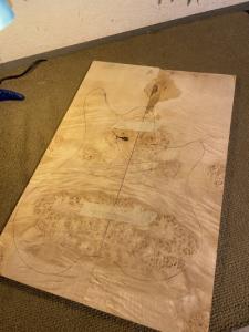

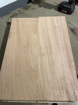

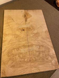

Fotos de las maderitas !
index.php?controller=forum&action=view_attachment&attachment_id=188354
index.php?controller=forum&action=view_attachment&attachment_id=188352
index.php?controller=forum&action=view_attachment&attachment_id=188353
index.php?controller=forum&action=view_attachment&attachment_id=188355
index.php?controller=forum&action=view_attachment&attachment_id=188357
index.php?controller=forum&action=view_attachment&attachment_id=188356
